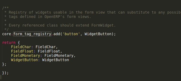

                        #11
                        @静静
                        是这个WidgetButton的render方法吧?那是renderElement()方法还是rendor_value()方法,有什么区别?
                        core.form_tag_registry.add('button', WidgetButton);
                        return {
                            FieldBoolean: FieldBoolean,
                            FieldChar: FieldChar,
                            FieldEmail: FieldEmail,
                            FieldFloat: FieldFloat,
                            FieldRadio: FieldRadio,
                            FieldStatus: FieldStatus,
                            FieldMonetary: FieldMonetary,
                            WidgetButton: WidgetButton
